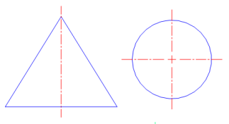

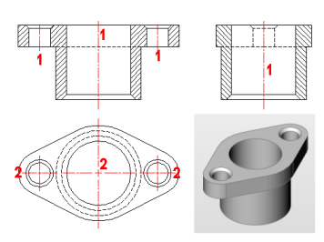

Centerlines and center marks
Centerlines and center marks are drawing reference entities to indicate axes of symmetry and centers of circular openings. Centerlines and center marks are associative entities: when the referenced lines, circles or circular arcs are modified they are adjusted automatically.
- Centerline
- Center mark
The CENTERLINE command creates a centerline entity associated with two selected lines.
The CENTERMARK command creates a center mark entity associated with a selected circle or arc.
The CENTERREASSOCIATE command recreates the association between a centerline entity and two selected lines, or between a center mark and a selected circle or arc.
The CENTERDISASSOCIATE command breaks the association of centerline and a center mark entities.
The CENTERRESET command resets centerline and center mark entities.
