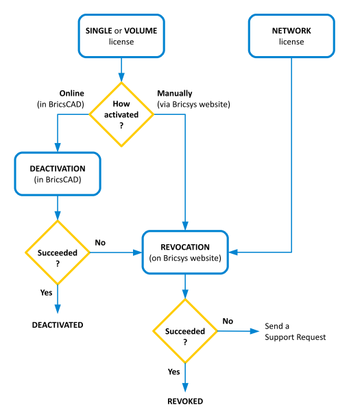

The chart explains how to deactivate a BricsCAD license. If it is not possible to
deactivate a BricsCAD license, you can
revoke the license.

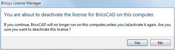

Click Deactivate...
Click the Yes button on the confirmation dialog box to deactivate the license.
The license is deactivated and can be activated on another computer.
Revoking a license
Only revoke a license if deactivation is not possible.
Use this procedure to:
Deactivate a network license or a single or volume license manually that is manually activated.

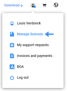

Log in to the Bricsys website.
Make sure you log in with the Bricsys account containing your licenses.
Click the My Account icon () and select
Manage Licenses in the menu.
