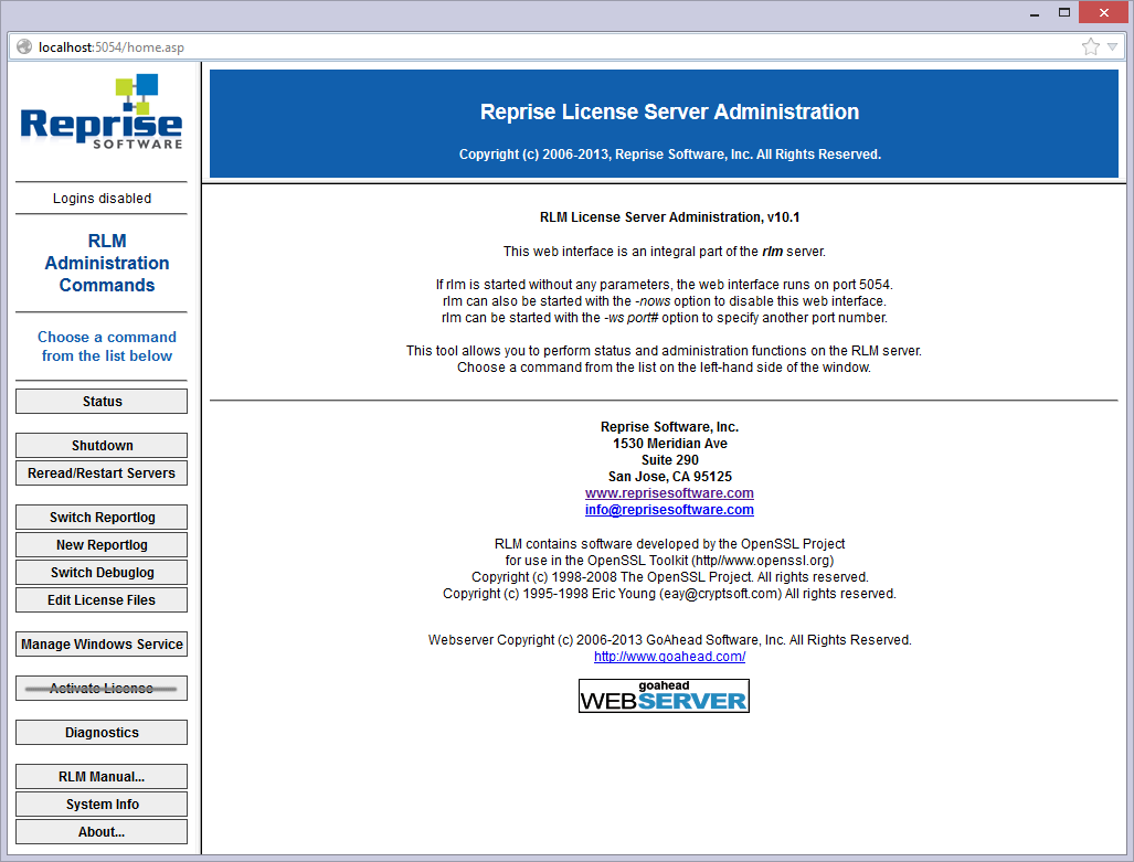

When the Network license server (also named RLM License server) is running, you can configure it in the Reprise License Server Administration web interface.
Opening the web interface
  1. If the network license server is not running, click the License Server shortcut in the Start menu (on Windows Vista or higher: right-click > Run as administrator).
    A console window opens.
  2. Browse to http://localhost:5054.
    The Reprise License Server Administration web interface opens.

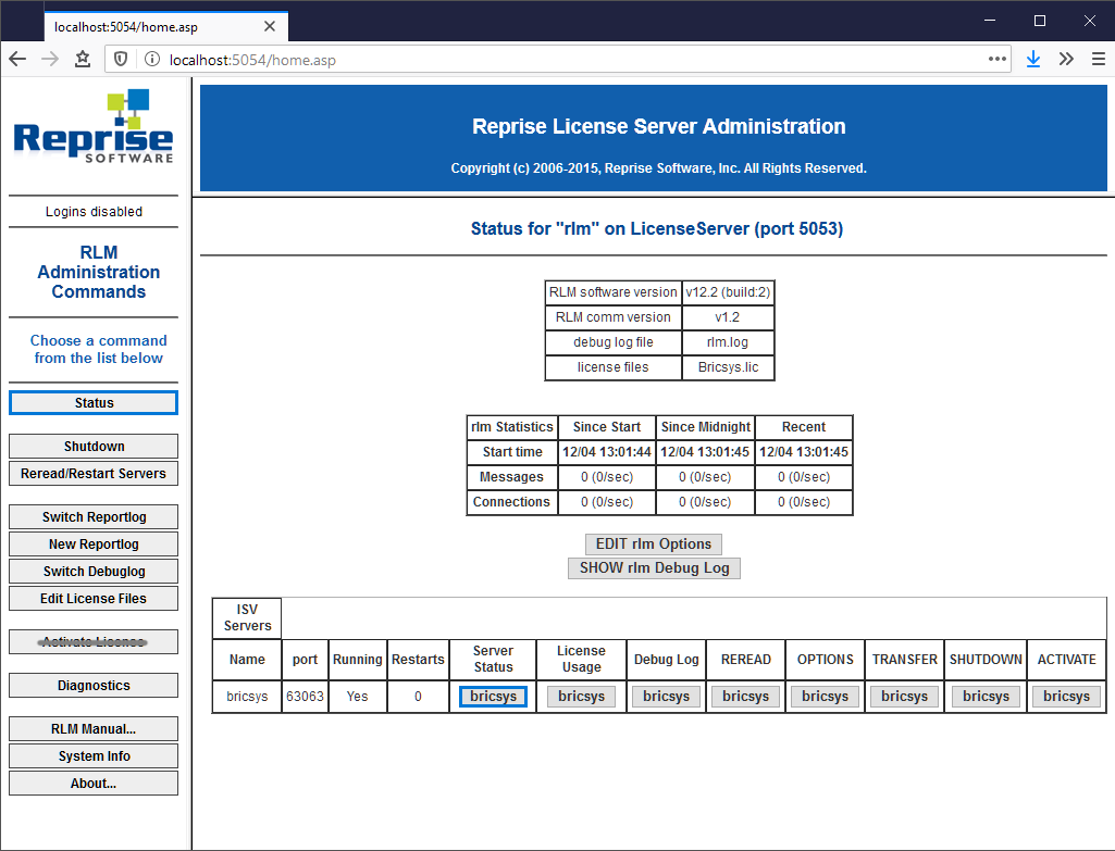

  1. Click the Status button on the left.
    The Status for "rlm" on LicenseServer (port 5053) page opens.

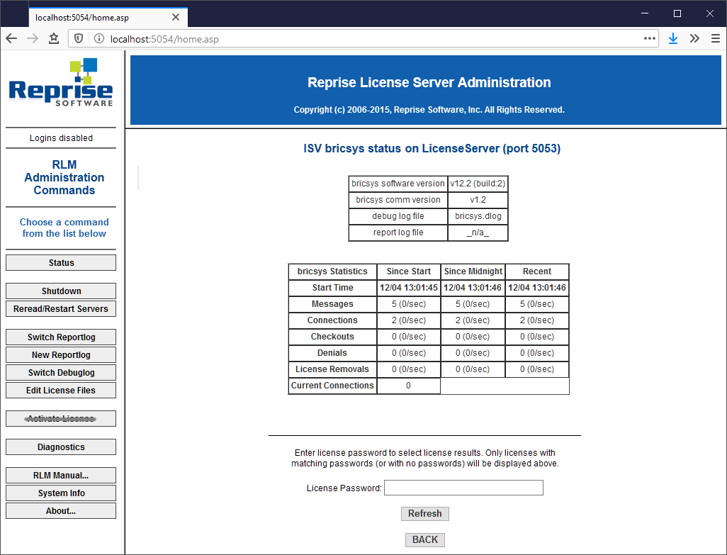

  2. Click the bricsys button in the Server Status column of the ISV Servers table to view the status of the Bricsys Network license.
