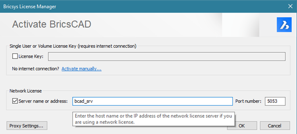

  1. Install BricsCAD with default settings.
  2. Start BricsCAD and activate Network License: <servername>/<ip number> and <port>
    (there may be no need for this as BricsCAD will check the network for a license server at start)
