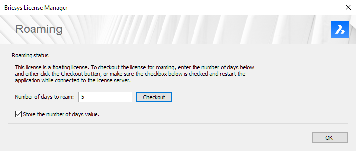

  2. Click the Roaming... button.
    The License Manager > Roaming dialog box opens.
  3. Enter the number of days you want to check out the license for roaming and click the Checkout button.
  4. (Optional) Tick the checkbox if you want to automatically refresh the roaming period when your computer is connected to the server.
  5. Restart BricsCAD® to apply the changes.
