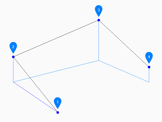

  1. Start
  2. Next
  3. Next
  4. End

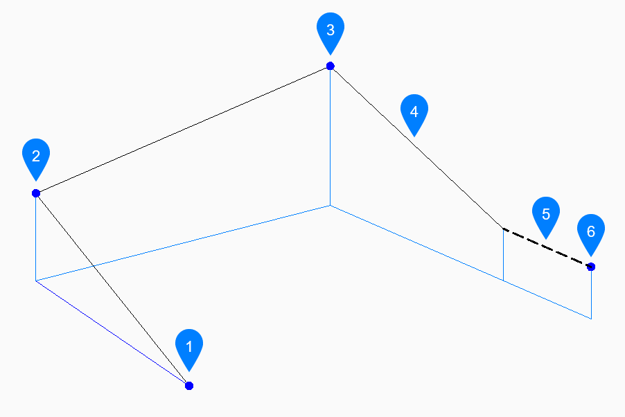

  1. Start
  2. Next
  3. Next
  4. Last Drawn Segment
  5. Follow
  6. End

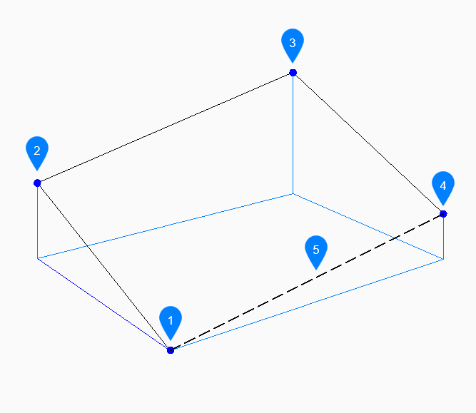

  1. Start/End
  2. Next
  3. Next
  4. Next
  5. Last drawn segment
