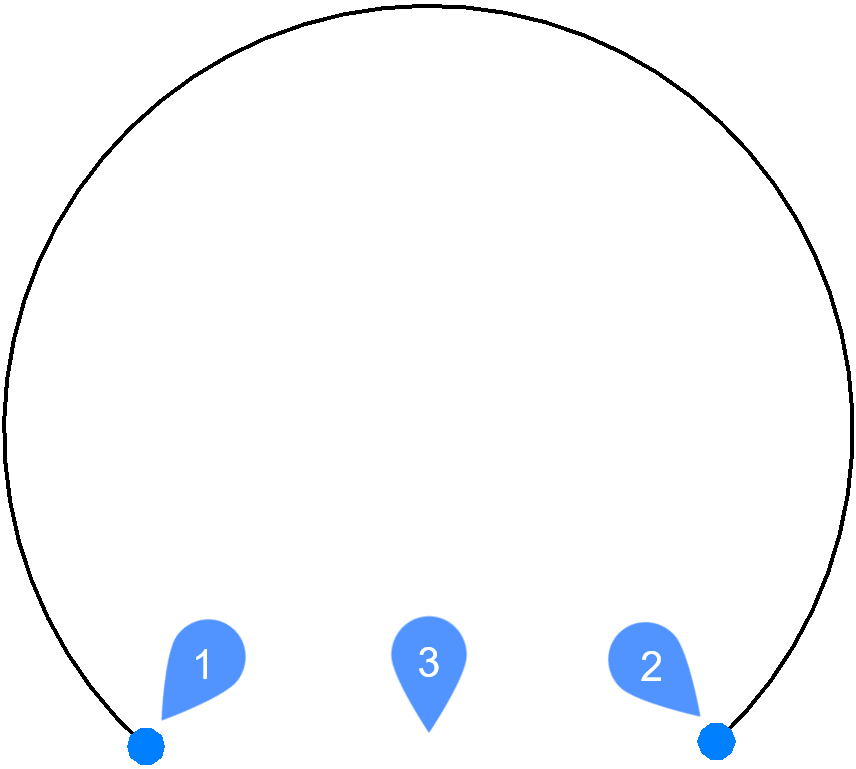

When breaking entities, you must specify two points for the break. The portion between the two break points is removed.
On arcs and circles, the break occurs in the counter-clockwise direction from first to second break points.
Note: By default, the point you use to select the entity becomes the first break point.
  1. First break point
  2. Second break point
  3. Removed portion
