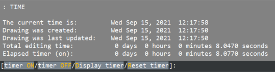

TIME command
Reports the use of time in the drawing.
Alias: TI
Reports the date and time the drawing was created, last updated, and spent editing; works at the Command line.
Options within the command
- timer ON
- Turns on the independent (“elapsed”) timer. The program reports, “The drawing timer is ON.”.
- timer OFF
- Turns off the independent timer. The program reports, “The drawing timer is OFF.”.
- Display timer
- Reports the date and time the drawing was created, last updated, and the amount of time spent editing (that the drawing was open).
- Reset timer
- Resets the independent timer.
