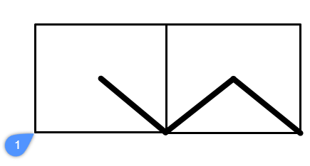

Select insertion point
Allows you to specify the X, Y and Z coordinates or pick a point for the block's insertion point (1). The Z coordinate is typically left at 0 for 2D blocks.

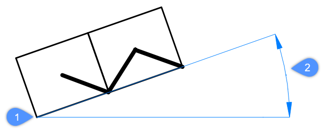

Rotate component
Specifies the rotation angle (2) of the block about its insertion point (1), starting with the x-axis as 0 degrees:
  • Positive angles: rotates the block counter-clockwise.
  • Negative angles: rotates the block clockwise.

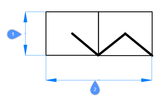

X scale
Specifies the scale factor along the X axis (2). Enter a negative value to mirror the block about the Y axis.
Y scale
Specifies the scale factor along the Y axis (1). Enter a negative value to mirror the block about the X axis.
Z scale
Specifies the scale factor along the Z axis.
